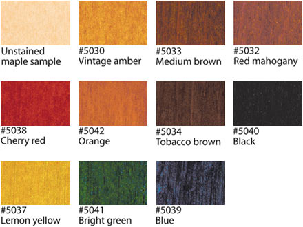

JJ the Seal Coat is a 50% amber/ 50% blond mix as is if you want it darker amber you can add some of the StewMac vintage amber transparent tint to your mix. It works well with shellac. It take very little be sure to make up a batch big enough to fish with as it is hard to get exactly same if made in small batches unless you use a very precise formula and measuring
MichaelP39091.7421643519
PostPosted: Tue Jan 09, 2007 12:02 pm
Thanks, Michael. I'm going to do some test panels ranging from straight seal coat to straight amber and some combos of the two. I'll bet I can find the tone I want that way. If not, I'll try the SM amber tint.

I've made up my own blonde shellac from flakes and have found that a 2 pound cut ambers maple nicely (well at least to my eye). I bought the StewMac Amber dye to darken it and never used it as I was pleased with the hue just from the shellac. If you shoot nitro over top it should amber up nicely all on its own. JJ I don't know if you remember the finished Archtop I brought to Bob's last summer. The top on it is Engelmann with a two pound cut of blonde shellac from Lee Valley.   Just my 2 cents.
